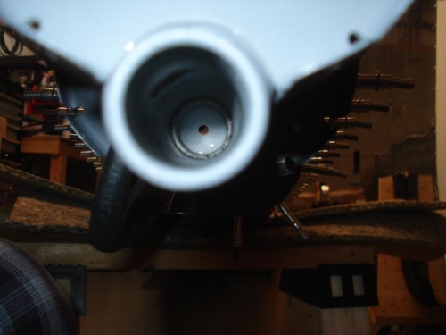

Setup for the tail spring mount.
Clecoed the tail spring mount to the two previously drilled holes after the location of the top of the spring mount is to be situated on the F-811 bulkhead assembly.
Made two 3/4 inch spacers.
Clamped the mount in place ensuring it was centred.
Drilled and clecoed.
Location marked out, clamped.
Spacers in place, and drilled.
Centered.
