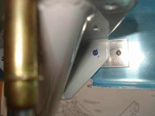

So each hole that you cant drill, you need to mark the centre of that hole so that you can take the pieces apart, drill the hole on the spacer first, then final drill with the cockpit rail and the support.
Picture 1 you can see the centre mark on the hole. There are two on each spacer you need to do.

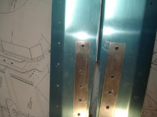

Picture 2 shows the holes marked in the spacer.
Hole centre marked for drilling
Holes marked
Holes marked
Drilled.
Drilled.
