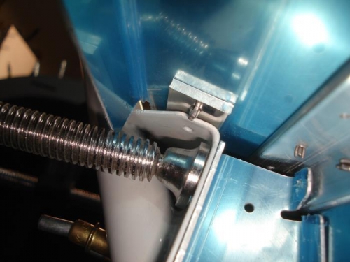

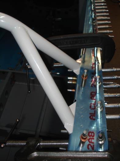

Using large C clamps, I had to remove a couple of clecoes to make this work.
You really need to tighten those C clamps and removed that gap.
Once both sides are tight and you verify the no gap with a mirror, drill away. There are two holes on the fore and aft that you can't get at while the seat back support assembly is on the aircraft.
Clamp it to remove the gap on both sides
Clamps and front and back of seat back support
