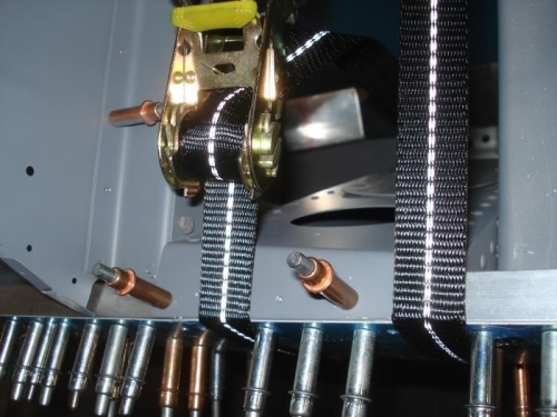

I used cargo straps to pull the outboard edge of the gear box flush with the vertex of the longerons.

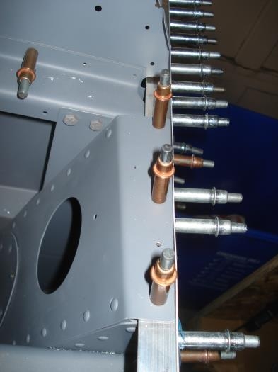

Using the drill cup, I matched drilled and clecoed the 5 holes in each gear box.
Looks good.
Straps pulling tight
Right done
Left done
