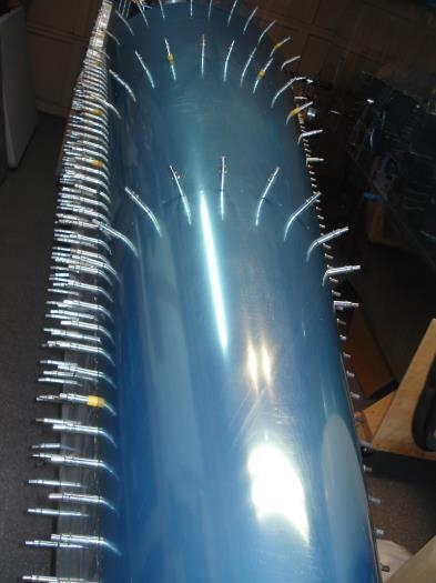

Aft top skin and aft deck
Aft top skin clecoed into position.
Aft deck centred, clamped and clecoed into position.
The F-812B-1 clecoed into position and the outboard holes drilled to #12 and bolts temporarily installed.
Areas to be removed for the stab bars and the F-812 bulkhead assembly marked.
All holes final drileld to #30 and #40.
Skin is flush to the longerons.
Aft skin clecoed into position
Rear deck centred, clamped and drilled.
