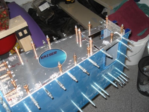

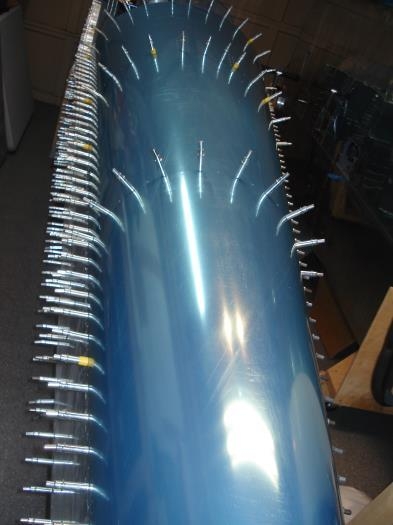

Bulkheads were clecoed in place and the aft top skin was clecoed in place.
The F-819 aft deck was centered, clamped and drilled to #30.
The cutouts for the stab attach bars were marked and the aft part the longeron was also marked for removal.
The #12 holes were drilled in the F-812B-1 and the skins were flush with the longerons.
Aft top skin in place
Aft deck drilled in position.
