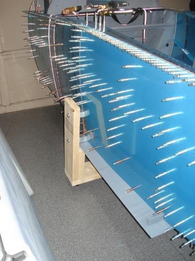

Final drilled all the #30 and #40 holes in the mid skins and the bottom of the aft bottom skin
Final drilled all the #40 holes in the aft side skins and the mid and lower longerons.

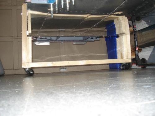

I built a quick dolly, which was drilled to fit into the spar blocks that I have in the spar box. It works very well and the wheels are casters, which make moving it around very easy.
The bottom skins were final drilled to #30 and the 4 holes to #40. The bottom tail cone skin was also final drilled.
