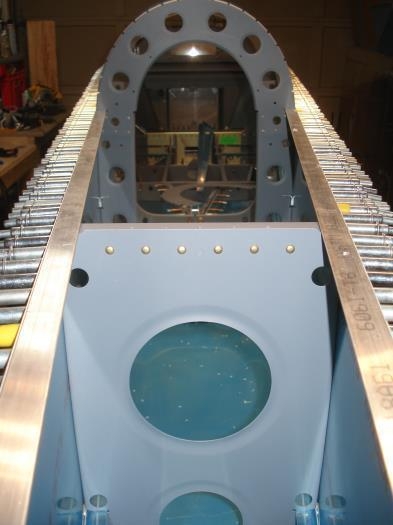

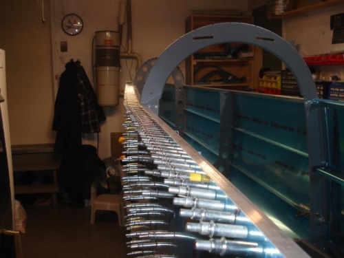

It only took me two hours tonight to drill all of the right side upper longerons.
Started by making sure the upper engine mount bracket was tightly flush and secure with the longeron and started drilling the #30 holes.
Moved my way toward the rear for the #40 holes, keeping the skin nice and flush with the vertex.
I'm very happy with the results.

Upper right longeron drilled through the upper engine mount.
View towards the tail section
