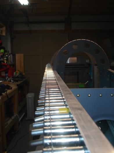

Brief Description:  Upper longeron and skin drilling #1
After getting numerous clamps out and making sure everything was tight, the skins were lined up with the longeron vertex, and the upper engine mount brackets were properly secured, I started drilling away with the drill cup. It can't be stressed enough. If you are doing this or coming close to this stage, GET A DRILL CUP! It's worth every penny!.
I made pretty good time with the upper longeron, moving my way to the tail section. I clecoed every hole.
I ensured that all of the tabs to be drilled through were backed by wood.
Once the upper longeron was secured in place, I finals drilled all the #40 and #30 holes on the left side of the fuselage. Tomorrow night, I'll repeat the process for teh right side. I have family coming this weekend, so there won't be much building going on.
I'm very happy with the results.

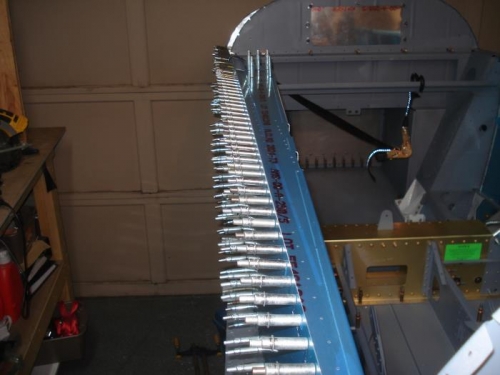

Front and mid skins and left longeron riveted in place

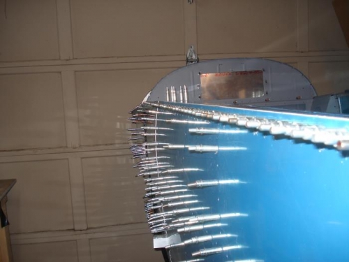

Cockpit rail clecoed in position.
