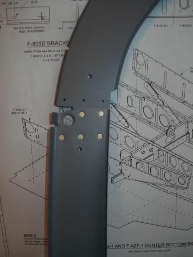

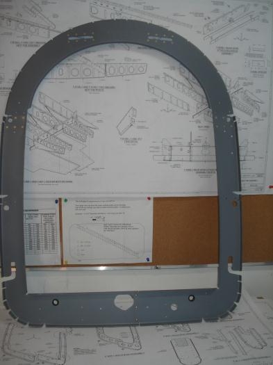

Clecoed the F-808 bulkheads, final drilled the common holes
Flanges straightened, deburred, scuffed, cleaned and primed.
Riveted on the left and right bulkheads together and added the snap bushings.

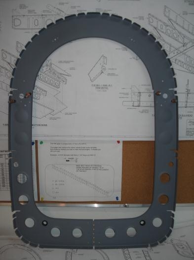

Clecoed the F-807 bulkheads, removed the identified areas as per the drawing, Final drilled all the required holes.
Dimpled the required #40 and #30 holes on the forward side.
Scuffed, cleaned, and primed.
Riveted together and added teh snap bushings.

F-808, riveted and the top bulkhead clecoed at this time
F-807 bulkhead riveted in place
Make sure you dimple the forward side of the joint with the top bulkhead.
