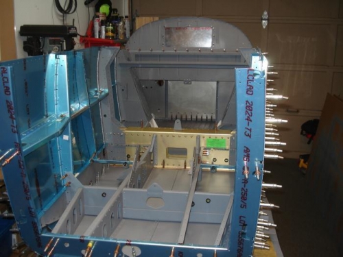

Seperated the F-805 floor support angles and deburred.
The F-860 L&R Fwd arm rests, F-860B L&R middle arm restes, and F860C L&R aft arm rests were deburred.
The F-805G gusstes and F-815 L&R outboard seat rib angles were deburred. and every final drilled.

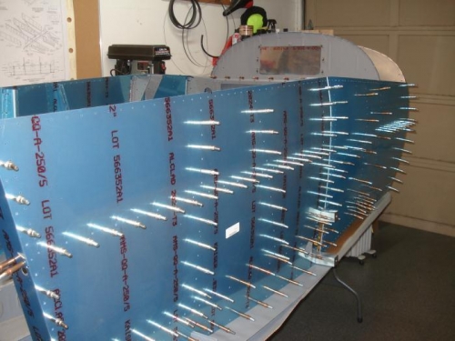

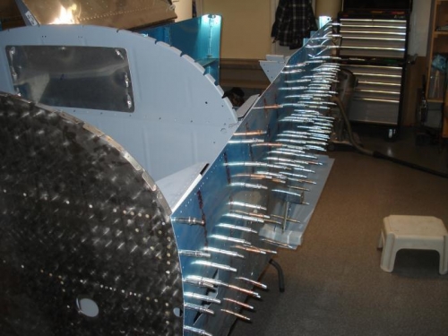

Clecoed the F-823 skins to arm rest assemblies.
What I found easier here is to put the rolled portion in first and then cleco everything in position.
Final drilled all matching parts.
Parts al clecoed
