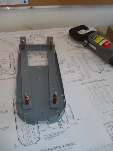

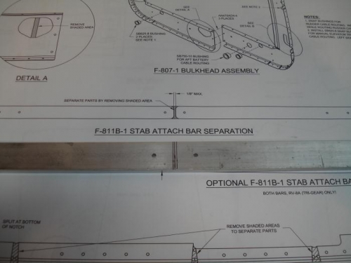

Seperated the F-811 stab attach bars.

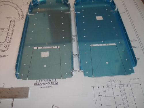

Removed the portion of the F-811A and F-811E-1's as per the drawings.
Final drilled and marked
Deburred, cleaned and primed.
Riveted.
The one AN470-AD4-4 holes in the centre had to be bucked.
The F-811 stab bars are not riveted to the F-811C-1 at this time.
F-811 stab bar to be cut.
Cut out area drawn
Primed and riveted.
