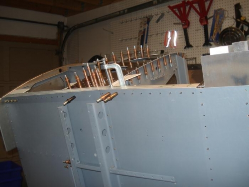

I used brand new #30 drill bits for this, and went through a couple of them.
Repeated the steps of the left lower longeron and drilled all the #30 holes, enlarged the #12 and #19 holes and clecoed everything up as I drilled.
Vacuumed all of the shavings up and did a little tidying in the garage.

In picture #3, you can see the rear rudder pedal brackets have been installed. Install those now before you go any further in the build. It's just so much easier to do it.
Assembly on the side for easier drilling.
Right side clamped
Right side clamped
Right lower longeron all drilled and clecoed and rear rudder pedal brackets installed.
