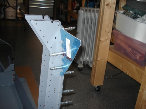

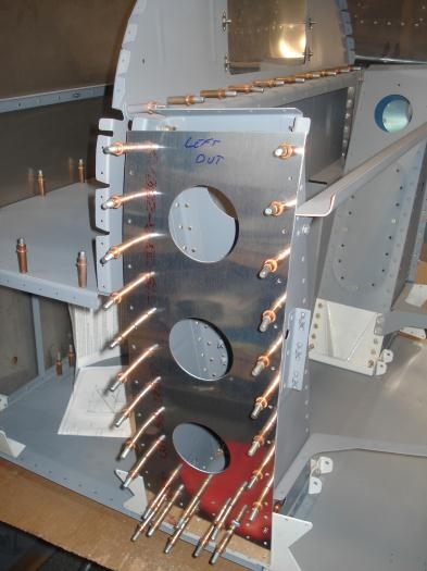

Prior to starting the bends for the F-804H, I reviewed the plans and completed the slight bend for the F-844 auxilliary longerons. As per the plans, the were bent slight to achieve the dimensions on DWG 66.
Marked the F-804H's every 1/2 inch up to 4 1/2 inches. I clmaped a piece of oak to my bench with 1/8 spacers and added a slight ucrve on the bends lines that were drawn.
Also added a curve to the F-802D-1's as well, using the same method.
I seperated the F-848 gussets and the F-8456.
F-802 gear box plates curved and clecoed
F-804 centre section plates curved and clecoed
F-848 curved and clecoed.
