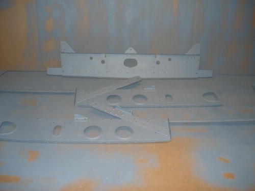

The F-806 bars, seat lugs, and gusstets were clecoed and riveted to teh F-806 bulkhead.
The nutplates were riveted to the inboard seat rib angles and then the seat belt anchor assemblies were clecoed and riveted to the inboard seat ribs.
The angles were clecoed and riveted to the ribs as well as the F-805 brackets.
The seat rib assemblies were clecoed to the F-806 bulhead and riveted in place. I was able to use the squeezer on most of teh rivets, but a few had to be shot.
The F-813 outboard seat ribs were also clecoed and riveted into position on the F-806.
Bulkhead and inboard seat ribs

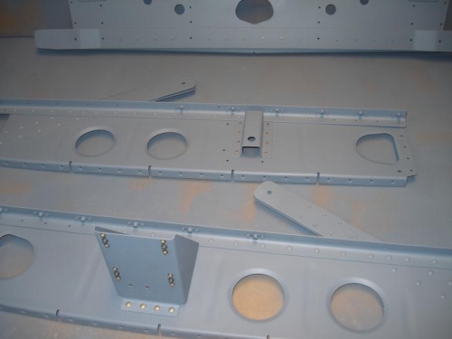

Brackets for electirc aileron trim installed
