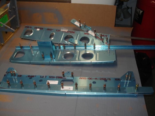

Entry #2 today.
Finald drilled the bulkhead to #30.
Final drilled all of the nutplate attachment holes in the F-814C-L/R.
Clecoed the F-814C-L/R. to the F-814A-L/R seat ribs. Clecoed the seatbelt anchors and the F-805D brackets and matched drilled to #30.
Match drilled all the #30 holes.

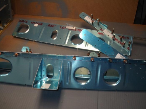

Also pulled out the electric ailreon kit, and started addressing the brackets in both seat ribs. Using the template, I matched drilled the holes in the F-814L and traced the area to be cut out. Tested the bracket for fit, all good.
Also match drilled the other bracket to the F-814R
That's enough for the night.
Rear spar attach bulkhead final drilled.
Forward inboard seatribs and angles final drilled.
Electric aileron  trim bracket match drilled.
