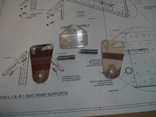

Made the two F-804M seat belt lug spacers to 1 5/16.
Deburred the F-804L seat belt attach lugs.

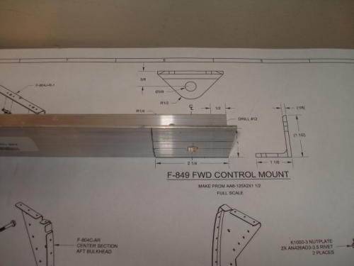

Made the F-849 control mount. I didn't read the instructions here carefully. I drew the lines and holes as per the plans for the F-849 control mount, but instead of drilling only one hole to #12 and then match drilling the other one with the centre section F-804A-2.
The control mount fit no problem, I just have to make sure that's it's completely square. If not, I'll being doing this one over.
Making the F-849 forward control mount

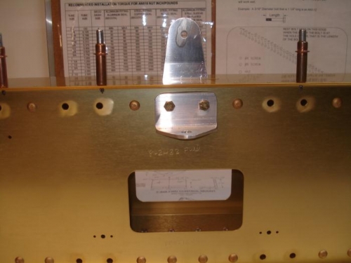

Seat belt lug spacers, contirl mount, and the Seat belt attach lugs
Checking for fit.
Checking for fit.
