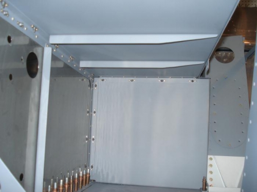

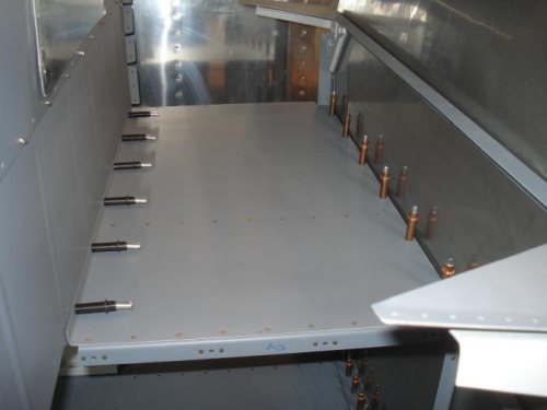

The stiffeners were back riveted to the baggage floor. The nutplates were rivetd in place.
The F-866D mounting plate was riveted to the aft of the F-866A-1

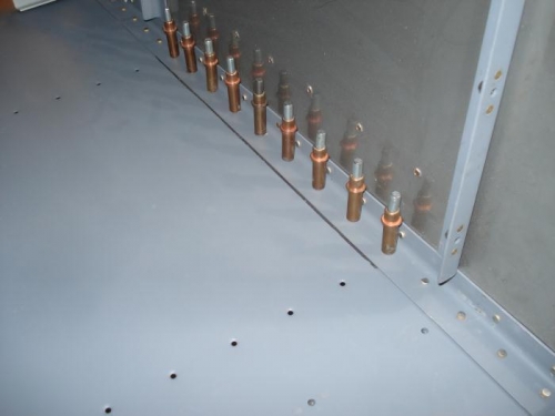

I countersunk the 9 holes in the F-801D-1 flange to accomodate the #30 dimple from the F-890-1 forward floor.
Mixed up a small batch of sealant, replaced the firewall and clecoed all 9 holes.
I then riveted the firewall to the F-890-1 floor, leaving the 9 centre rivet holes clecoed.
Forward fuselage sub structure is complete for now. Still have to install a hing for the avionics access panel from the baggage compartment.
Firewall sealed and clecoed
Baggage floor clecoed in place
Another angle
