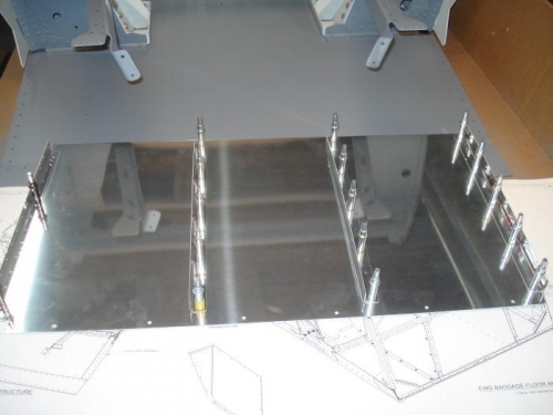

Started with the fluteing of the F-866B-1 and A-1. Really? Very difficult to flute.
Seperated the stiffeners from the F-807BE and the F-807CD, removed the taper, then deburred all of the parts.

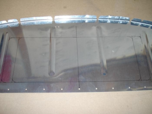

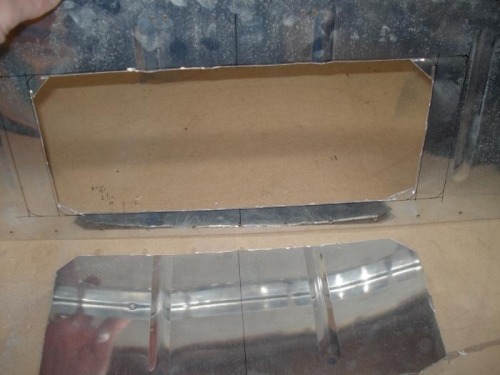

I marked out and cut the mod that many RV-8 folks have done in order to gain access to the avionics. I'll add a doubler and hinges, along with a few nutplates later.
Clecoesd the F-807D-1's and C-1 to the 870-1 floor, finald drilled, and deburred. Also final drilled the nutplates for all the parts.
Clecoed the F-866 mounting plate, final drilled it, counter sunk the 866 for the dimpled 866A-1, which was also dimpled.
Cout out drawn for avionics access
Avionics access cut ou t
807 D's and C cleoced and final drilled.
