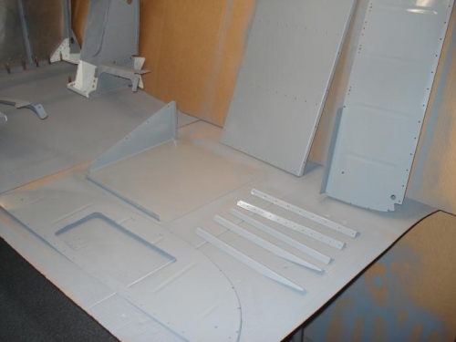

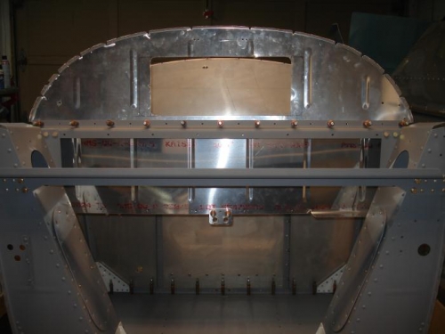

I clecoed the uppder F-807B-1 to the F-807A-1 and the F802N-1 and final drilled all the #30 holes.
Removed all the parts, deburred everything, including the screw holes.
I also dimpled all the holes for the nutplates in all the parts and dimpled the bagge floor and stiffeners.
All parts were primed. Start riveting tomorrow.
F-866 A1 and B-1 cleoced to teh 802N-1
Everything getting some primer
