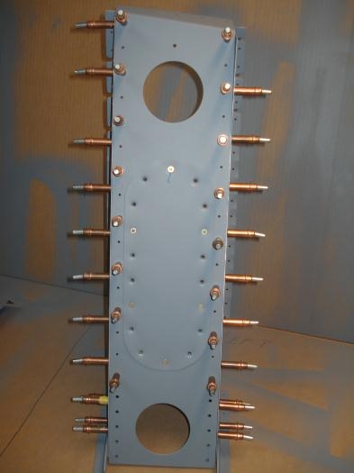

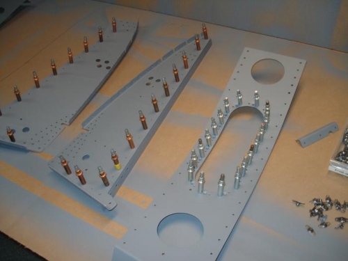

After dimpling the access covers to #8, I also dimpled the F-802C's to #8 as well.
I clecoed the forward and aft bulkheads together and then clecoed the K1100-8 platenuts to the F-802C's and riveted them in place.
Tested the access cover for the gear tower and it fits like a glove. I'm quite happy with the results.
Tomorrow night, I'll complete the riveting of the gear towers.
Nutplates for teh access cover clecoed
Nutplates installed in the F-802C's
Access cover tested for fit.
