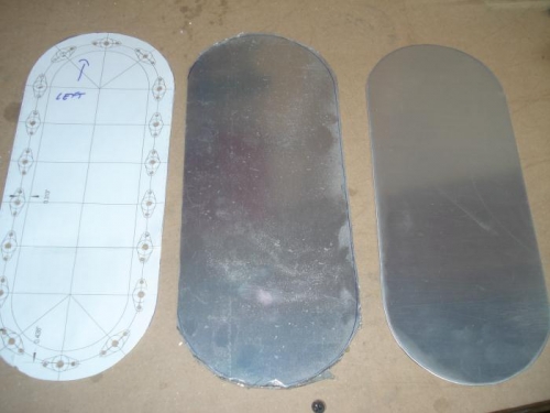

Used some .040 Alclad T3 2024 and used the previous templates for the left and right boxes, traced, rough cut, and then cleaned up on the scotchbrite wheel.
Once deburred, I landmark the top and bottom nutplate holes, drilled and then clecoed to the F-802C's.

Template, rough cut to finished product

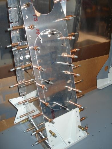

Left tower done
Left tower done
Right tower done.
Right tower done.
