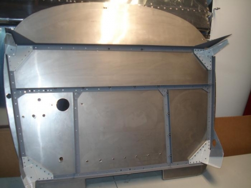

Finished off the firewall tonight.
Started with the nutplates and installed all of the nutplates on the firewall and the angles.
Finished riveting the brackets and a few angle holes.
Had to drill out a number of rivets as they weren't flush with the skin when I back riveted them. I then placed the firewall in a vice and bucked them in place. All is good.
Pulled out the pieces for the cooling ramp and the floor.
I'll get to that tomorrow night.
Rear side of the firewall all riveted

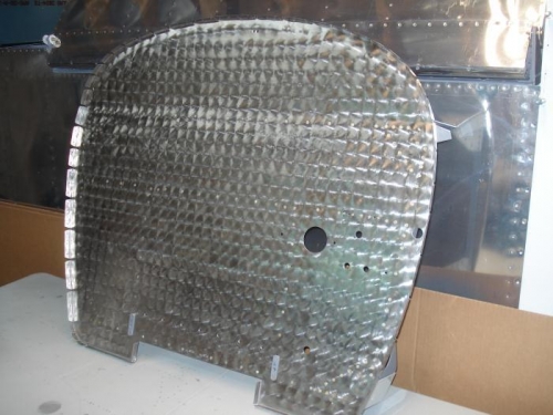

Forward side of the firewall

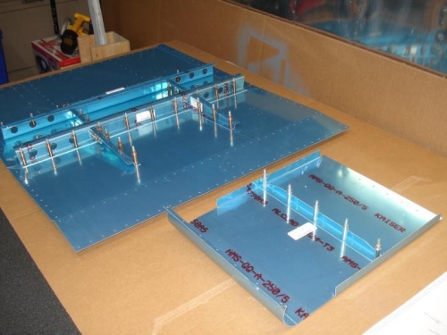

Forward fuselage floor getting started
