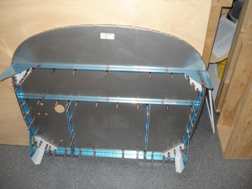

Got started on the firewall tonight. As a result of setting up the excel spreadsheet, it took about 2 minutes to find every piece I needed to start the firewall, including the F-801L backing plates that are placed in a hardware bag. For those going down this road, I think it's a must in order to save time searching for pieces.
Anyway, I removed the tabs from the F-801E side angles and the F-801C upper angle. I cut the gussets and the spacers apart with snips (not that hard) from the F-801JKWY, where the tabs were also removed.
The F-801 Upper angle, lower angle, side angles, middle angles, and centre angles were all clecoed in place.
The two upper spacers and WD-802 engine mount brackets were clecoed in place.
The two lower spacers and WD-803 lower engine mount brackets were clecoed in place. A word of caution here. Some would think that you would clecoed the bottom engine mount brackets just like the top ones. WRONG! You need to basically twist the W-803 under the flange of the F-801 side angles that the 801 is on the inside of the bracket, not the outside. The manual isn't very clear on this. At first I thought there was an issue, looked at the plans a few more times and then figured it out.
Once all of the brackets were in place, the gussets were clecoed in place along with the F-801L backing plates.
Don't drill the 1/4 inch hole in the backing plates unless you are using inflight adjustable rudder pedals.
I then final drilled all of the #30 holes, and the #40 holes for the nutplates.

Firewall clecoed together
Final drilling completed
