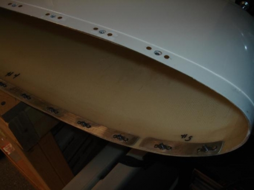

Right wing tip install #7
I had enough K1000 nutplates to do the right wingtip. I didn't have any 3-4 rivets, so I used the rest of my -5's and cut them down to size.
After spending the previous night drilling out rivets, I was glad to be squeezing these ones.
Test fitted the tip with the rib in place and all seems good.
I will have to do a little bit of glass work on the actual joint from the tip to the skin to get a nice transition.
I'm going to finish off the wingtip light plates and the lens tomorrow night.
The proper nutplates riveted in place
All done.
Test fit looks good.
