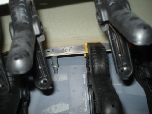

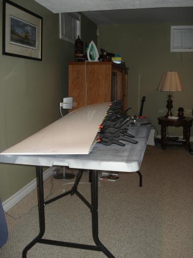

Scotchbrited and cleaned up the reinforcement strips and rough up the area of teh fivreglass for bonding.
Brought the work into the warm basement where the epoxy can setup properly. I mixed up the resin and hardener, mixed it well and then used a foam brush to apply the epoxy to the roughed up fibreglass surface. The strips were put in place with clecoes, the I clamped it all down and removed the cleoces.
Repeated the process for the the other side as well.
Once cured, I'll rivet on the nutplates.
Reinforcement strips epoxied and clamped into place
Clecoed and clamped
Clecoed and clamped
