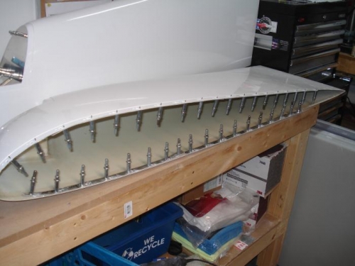

I marked each reinforcement strip and then removed one at a time, removed the blue vinyl, then deburred and replaced back into it's position.

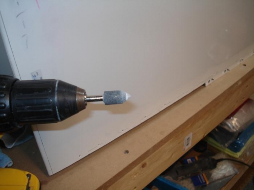

After all 6 pieces were deburred, I pulled out a tapered stone to countersink the rivet holes and the screw holes.
Using the stone, I was able to determine the right depth and then use the white line on the stone from the dust as a reference for all the other holes. Pretty easy and quick.

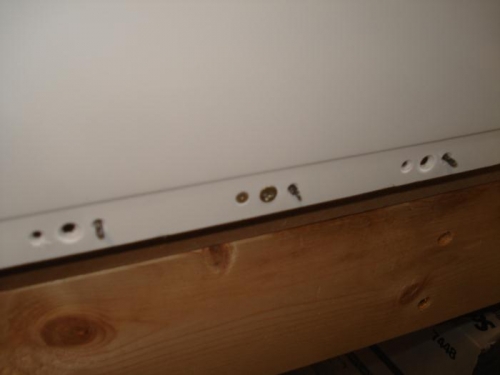

After the #40 rivets holes were done, I countersunk the screw holes in the same fashion.
Whatever you do, DO NOT use a metal countersinks on the fibreglass as it will dull the blades in no time, and the stone does a nicer and smoother job.
I'll mix a batch of epoxy on Wednesday and give that a shot with the reinforcements strips.

Reinforcement strips deburred and ready for epoxy.

Holes countersunk.
Holes countersunk.
