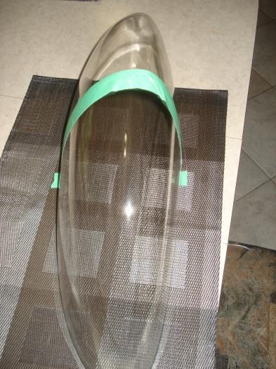

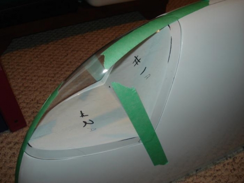

Started the lens by finding the centre of the two piece lens. Used the metal snips to cut the plastic and then I taped it to the wing tip and roughly drew the outline of the recessed area.
I then took the plastic to the belt sander and removed it to the line and then replaced back on the tip.
After about 4 adjustments, the lens fit pretty good. I then used 200grit paper smooth the edges of the plastic.
I'll finish off by adding the two nutplates to the wing tip.
Centre located for the big lens.
Left wing tip lens rough cut
Final cut
Final cut
