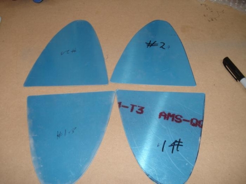

While waiting for the fuse kit, I decided to do a little work on the wing tips. I traced out the shape of the wing tip lights and transferred it to some spare aluminum.

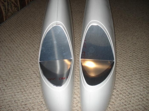

The shape was refined and the right wing tip reflectors were drilled and clecoed.
I then countersunk the fibreglass to take a #40 dimple, and then dimpled the reflectors.
These will be polished and then riveted in place one the Aeroleds position/strobe l;ights are in place.
Cut outs for left and right wing tip light reflectors
Wing tip light reflectors
Right wing tip light reflectors clecoed
