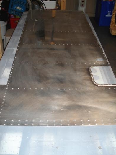

Left wings bottoms skins
Both the inboard and outboard left wing skins were deburred, scotchbrighted, and cleaned.
After cleaning, both bottom skins were dimpled, and then cleaned again.
After cleaning, I sprayed both with primer. In picture #3, you can see the overspray still in the air.

Scarf joint
Bottom outboard skin
Skins primed
