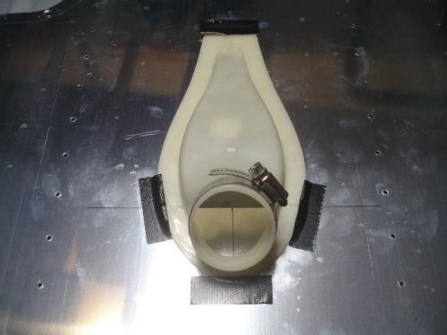

I ordered the NACA scoop and tubing from Van's prior to waiting for it in the fuse kit, so that I could final close the wings up.

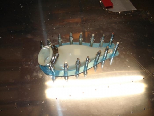

I marked out the location on the wing and set out the rivets I wanted to set. After drilling the scoop to the wing skin, I fabricated two doublers so that the rivets had something to bite into.

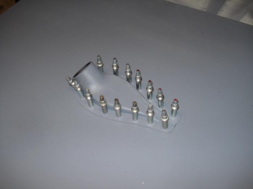

After forming and deburring them, they were matched drilled and then primed along with the scoop.
I didn't use any pro-seal, but a layer of RTV under the scoop to form a nice seal. After riveting it onto the wing, I added a piece of window screen onto the intake prior to permanantly attaching the tubing. Don't want any bugs or whatever coming through!
Placement set
Placement set
Doublers in place,
Doublers in place,
Primed and ready for riveting.
