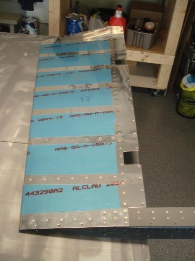

Brief Description:  Right elevator #4
The right elevator was fairly simple to finish riveting. The required rivets were set in place and the squeezer was used to attach the spar in place.
Just have to finalize the rlling of the leading edge. Once both elevators are completed, I'll weigh them to see how much lead I may had to add to counterbalance them. I expect to add more lead to teh right elevator as a result of the trim servo in the left elevator.
Skeleton clecoed.
Skeleton clecoed.
Spar riveted in place
