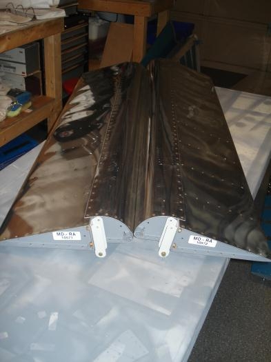

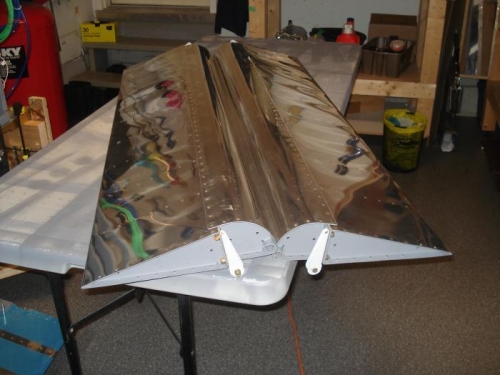

Right and left aileron final riveted.
Both the right and left aileron's were closed up for good. The bottom skin was placed in positiion and the skins were blind riveted to the spar.
The end ribs were also riveted and the last two rivets in the trailing edge had to be flush pop rivets.

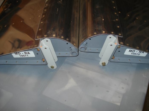

The brackets were bolted in place, torqued, and a dab of torque seal was added.
Left and riget ailerons closed
Brackets bolted in place
MDRA stickers in place and torque seal added
