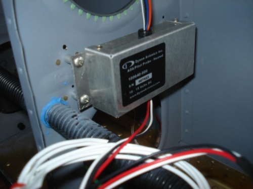

I did install the #6 nutplates for the Dynon pitot heater module. This was located in the bay where there is quick access through the inspection port where the bell crank lives.
As a result of the rise with the rib, I had to make some standoffs out of aluminum vent tube that I had left over. I picked up some #6 stainless screws from ACS and mounted the heater module.

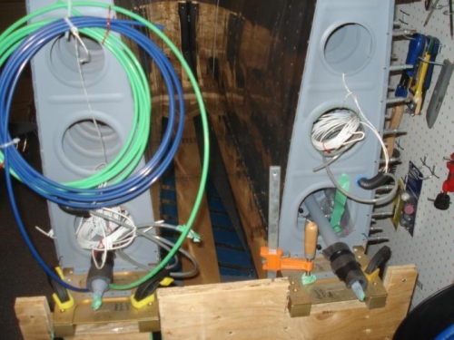

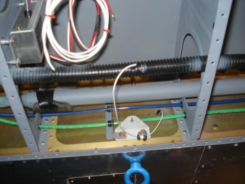

I've also run the wires for the Duckwork lights, the heated pitot tube, stall warner, and nav lights through the conduit. No issues with that. I placed a temporary adel clamp on the mounting bracket, but don't like the setup. I don't think the wire should wear on the conduit, but if there is a chance it will, I'll add another run through the ribs to accomodate that unless I can get it through the pitot tube line passage way.
