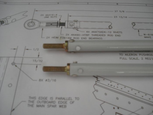

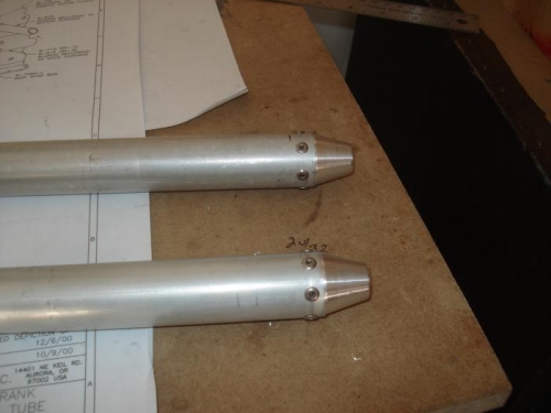

Assembled the W-816 and W-818 pushrods. Measured both pushrods and cut both sets to length as per the plans.

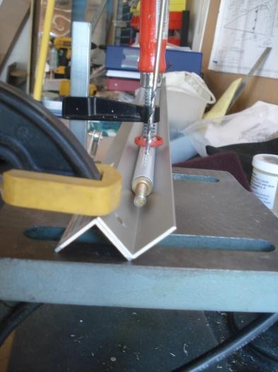

The interior of both sets were primed and allowed to set. I created a simple jig with two pieces of aluminum angle so that I could drill the the pushrods.
The AN49OHT8P and the VA-169 rod ends were set and drilled. I used 4-11's for the one set and the called for pop rivets for teh other. No issues with the 4-11's at all as they were bucked and not squeezed.
I set the rod end bearings in place and set as per the dimensions in the plans.
Time to prime
Time to prime
Simple jig to drill straight
Rod ends riveted in place.
