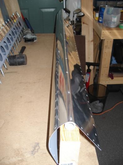

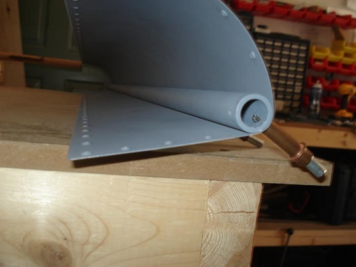

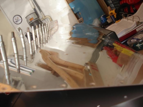

After deburring and priming all of the right aileron parts, the stiffeners were backriveted in place, RTV added to the trailing edge where the stiffeners meet the trailing edge, and then the counterbalnce was popped riveted in palce after the leading edge was dimpled with a #30 dimple die. I used the squeezers piston to do the trick
Stiffeners riveted in place
Counterbalance primed and clecoed
Counterbalance riveted
