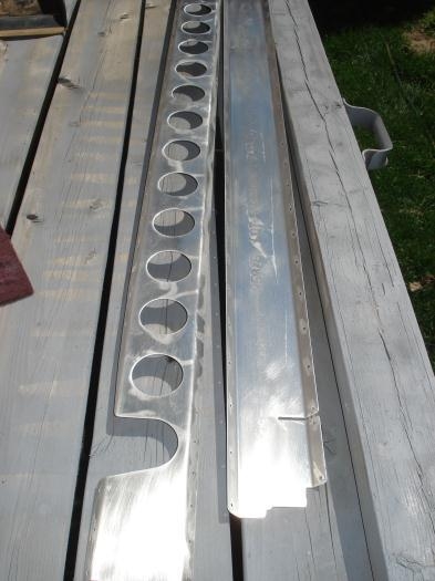

Brief Description:  Left wing flap brace and aileron gap fairing
Finished deburing the left flap brace and aileron gap fairing with my dremmel and the 1 inch scotchbrite wheel. A scuff with a burgandy scotchbrite pad, a cleaning with acetone, then primed.

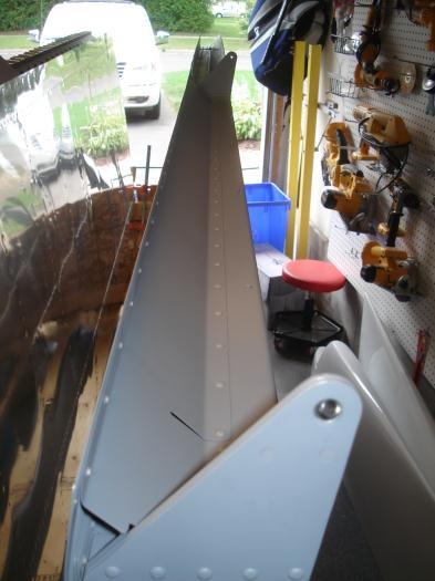

Dimpled the aileron gap fairing and riveted with the squeezer and the used the off-set rivet set for the AN470 4- rivets. Quick and easy work.
Deburred, scotchbrited and cleaned
Primed
Primed
Right wing flap brace and aileron gap fairing riveted.
