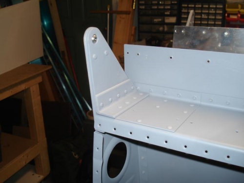

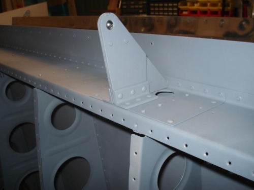

Brief Description:  Left wing aileron hinges #1
I scotchbrited, cleaned, and then primed my aileron hinge brackets for the left wing. I clecoed and riveted the outboard hinge bracket, ensuring that the countersunk rivets were on the "outboard" side of the bracket...
The inboard bracket also needs countersunk rivets....on each side. I didn't make the same mistake as the right wing brackets.
I did club over one rivet on the outboard hinge bracket. When I drilled it out, I elongated the hole. I had a 5-7 rivet, drilled for size and then set that...no issues.
After they brackets were rivted, I gave it a quick shot of primer on the rivets. Make sure you use on offset rivet set here to prevent any damage to the brackets by the rivet gun.

Outboard hinge bracket installed.
Inboard hinge bracket installed.
