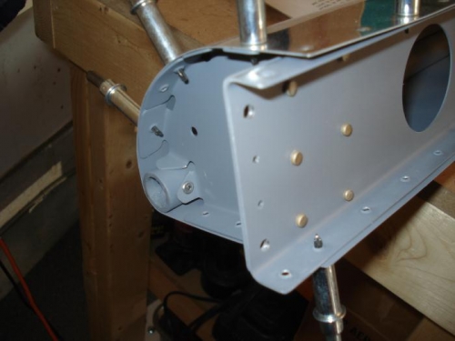

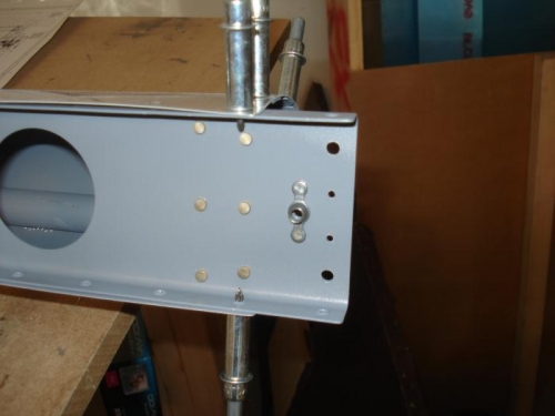

Left nose rib riveted in place
Right nose rib riveted in place

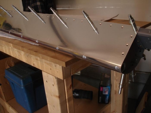

Counterbalance riveted.
