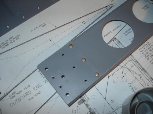

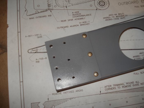

Had a few minutes before work to rivet the aileron brackets in place and countersink for the AN426 flush rivets. Installed the nutplate and then countersunk the counterbalance to #30.

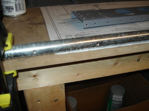

I'll do a quick cleaning on the counter balance and then prime inside and out.
I'll use the dimpling male die with the pneumatic squeezer plunger to dimple the leading edgeto countersink the leading with the counterbalance in place.
Aileron reinforcement bracket riveted
Nutplate countersunk and riveted with reinforcement
Counterbalance countersunk.
