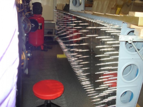

I started by removing the top skins from the skeleton and dimpled the ribs. After the ribs were dimpled, I finished deburring the left wing top skins, scotchbrited them with a maroon pad, cleaned and primed.

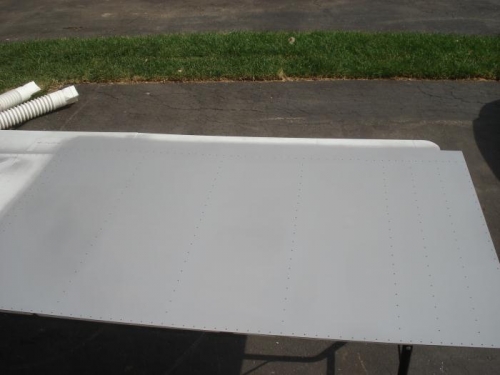

Once primed, they were dimpled. The wing walk doubler was also deburred, scotchbirted, cleaned, primed and dimpled.
Once all that was done, the skins were clecoed to the skeleton.
We're ready to rivet the top skins....back to work tomorrow for 4 days, so it's going to have to wait.
Interior of the left wing skins primed
Wing walk doubler and skins primed and dimpled
