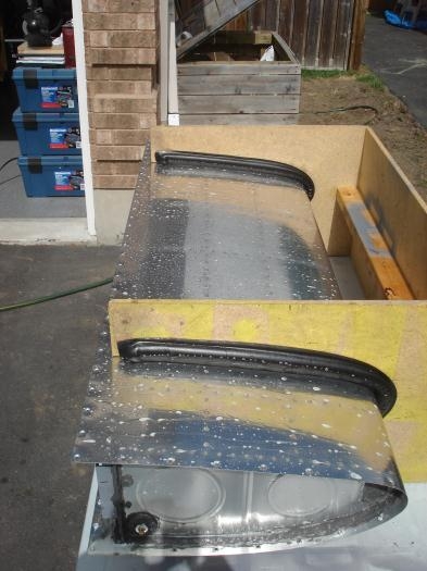

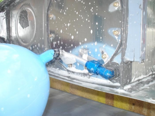

I used the Van's leak test kit and created a little connector for the balloon off of the return line.
Pumped the tank up slowly until I had some pressure in the tank and once the balloon inflated, I stopped the pumping of the bicycle pump. The balloon is basically a safety valve in case there is to much pressure.
Sprayed the entire area with a soapy water solution and watched very closely. The only area creating bubbles was the joint where the balloon was attached.
I'll call this a success and claim to have leak free left fuel tank!
I'll prime the baffle area and the inboard and outboard ribs later on.

Only leak was at the joint with the balloon

Top skins - no leaks
