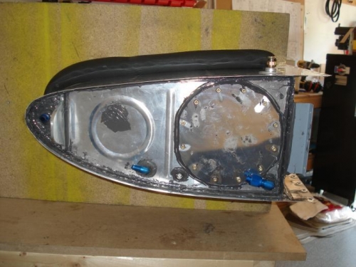

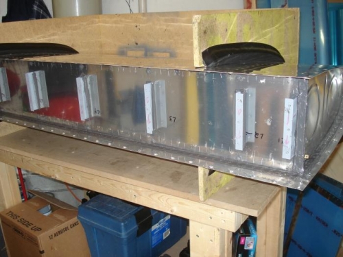

That's a wrap! Glad to be done this part of the build. Finished off the inboard and outboard Z brackets and riveted them to the baffle.
The standard remove every second cleco, clean, add proseal, insert a cleaned rivet and set. A couple of tight spots with the return line and the HW bung fitting in the way, but I managed.
Added the access plate, placed the hex screws inpalce and ensured a nice bead of sealant was squeezed out.

Baffle and Z brackets all riveted and sealed in place.
Inboard rib access plate sealed and hex screwed in place.
