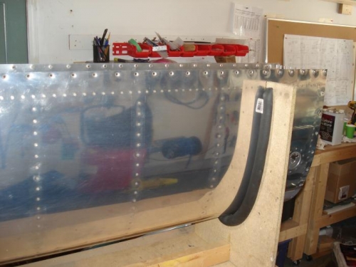

After riveting.
After riveting.

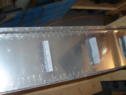

Top and bottom done
Top and bottom done

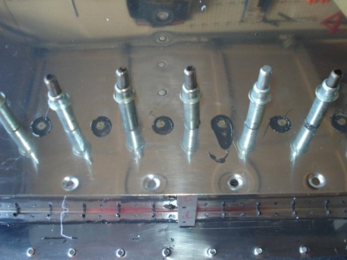

Nice and flush!
Nice and flush!
