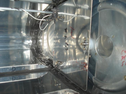

Date:  5-7-2012
Number of Hours:  0.50
Manual Reference:  Page 7-7
Brief Description:  Left wing fuel tank part #28
Entry #2 for the day
After the ribs were installed, I ran the wire from the BNC through the bushing and into the second bay. The wire was then connected to the ring terminal and both terminals were connected to the plate using the provided screw, washer and nut.
Once connected, a generous layer of proseal was added to the nut, screw and wires.
The plate was then attached to the rib with the screws and washers.
The setup was checked at the BNC connection to the plates, plates to the skin and plate to plate. All is good.
Inboard capactive plate installed.
