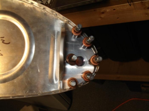

Brief Description:  Left wing fuel tank part #26
I grabbed the T-410 and T-405 for the inboard rib and the T-410 for the outboard rib. They were matched drilled and then deburred.
The T-410 for the inboard was also step drilled to match the T-405 for the flop tube installation. All parts were deburred and ready for install.

T-405 and T-410 in place on the inboard rib
