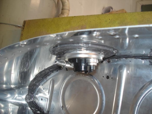

Brief Description:  Left wing fuel tank part #24
Spent some time back on the left wing fuel tank. I don't know why I didn't order more proseal with my last order from Van's....
Anyway, the vent line was installed, bent and mated with the vent fitting. The line was also married up to the vent line cllip at the fuel cap flange. Mixed about 20 grams of proseal, installed the vent line fitting in the inboard rib along with the BNC connector for the capactive plates. Proseal was added to both sides and the access encapsualted nutplates were also given some additional proseal.
Vent line rough fitted
Vent line and fuel cap clip
BNC and fitting prosealed
