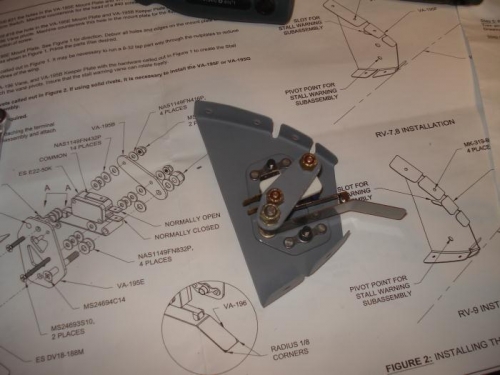

Removed the stall warning package out of the bag, deburred the necessary parts, cleaned and primed. After the parts were dried, the nutplates were installed, stall warner assembled and then the bracket was riveted in place.
The leading edge was removed for ease of installation of the assembly into the bracket.

Stall warning assembled.

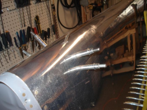

Stall warning clecoed in place.

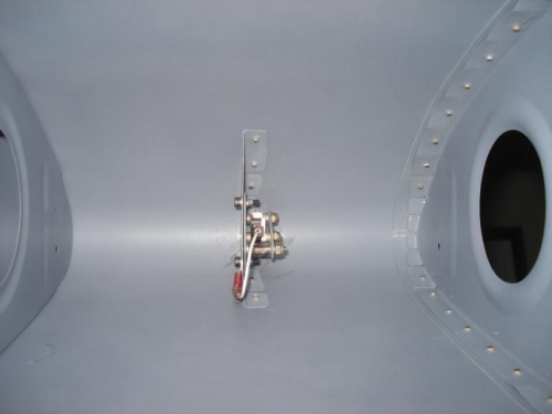

Riveted in.
Riveted in.
