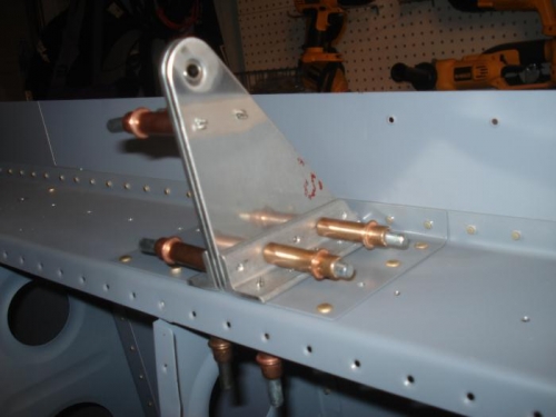

Retrieved the parts for the W-413 and W-414 aileron bracket assemblies and clecoed them in place along with the flap brace and aileron gap fairings. All holes were reamed to their appropriate sizes (#30 and #40) and removed from the wing.
The aileron brackets were then removed of their bearing and they were deburred on the scotchbrite wheel in the assembled position.
The parts will be scotchbrited, cleaned, primed and riveted together tomorrow.
Aileeron brackets and flap brace and aileron fairing clecoed in place
Outboard right aileron bracket deburred and final drilled
Inboard aileron bracket deburred and final drilled.
