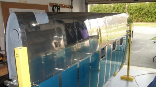

Brief Description:  Right leading edge riveting #1
Placed the right wing leading edge in place after cleaning the spar area up of shavings. I then clecoed the ribs and the skin in place for riveting.
I started with the skin first with the squeezer. Made quick work of the skins to spar riveting.
I moved onto riveting the ribs to the spar. I started of with 470's, but after shotting two of them, I went to LP-4 pop rivets. Much easier to do on your own.
Right wing leading edge and fuel tank in place
Leading edge riveted in place.
